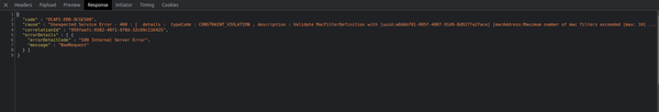

codejunkie
Oeps , er ging iets mis.. probeer later opnieuw
Hello, In my case, this error was shown when I tried adding more than 10 devices in the mac-filtering list. The original error is a bit mis-leading. The actual error is due to a 500 Internal server error which is caused due to constraint violation; the max number of devices being 10. This looks like a database constraint error to me.
